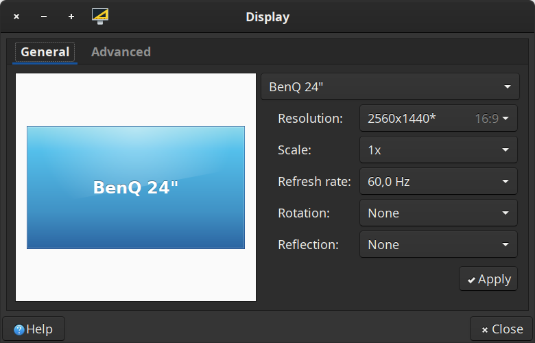

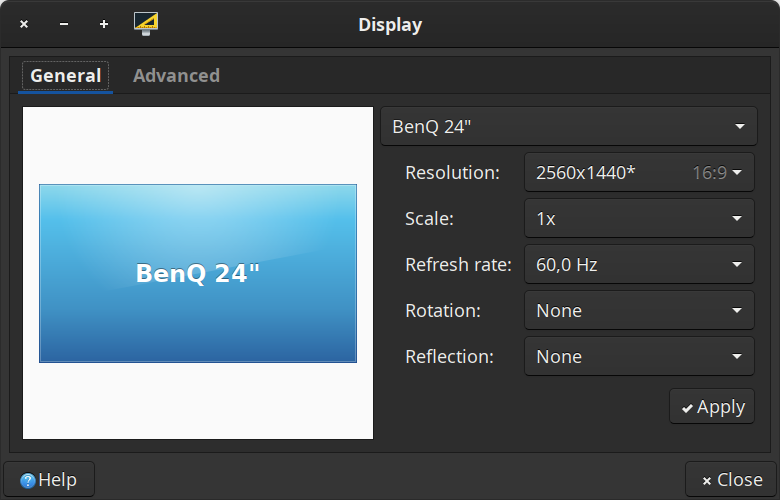

0) Settings > Display > General
* Resolution to 2560x1440 (16:9)
* Scale: 1x (!)
When using "scale<1.0" for resizing to match your UI for 2k high-dpi display, things get (at least on my system) quite blurry. Looks like in the early days of LCD displays, when we were used to setting a lower resolution to "zoom" the image on CRTs for our grand/parents. Not so clean IMO.
So I leave the scale at 1.0.

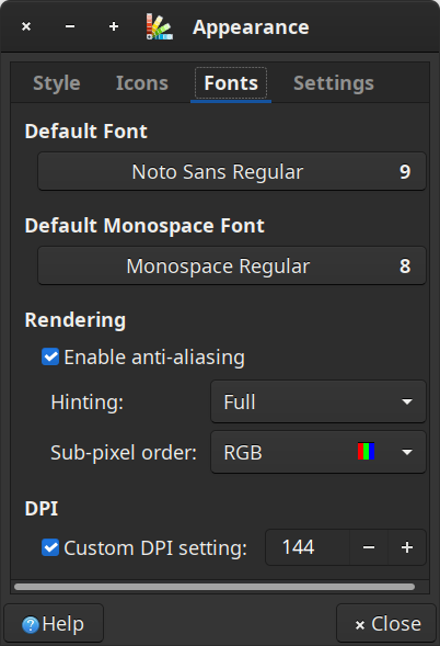

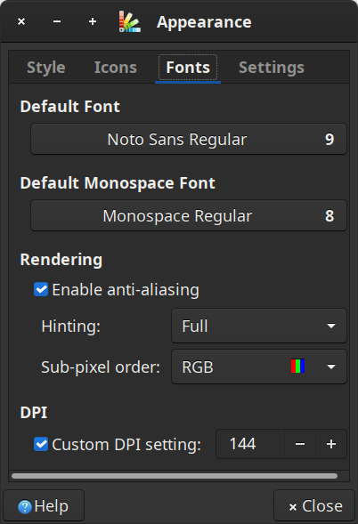

1) Settings > Appearance > Fonts: Custom DPI setting
I've set my font DPI value to "144".

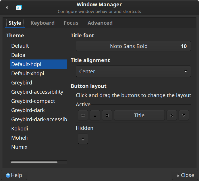

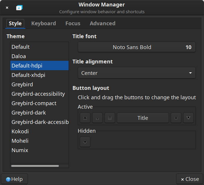

2) Settings > Window Manager > Window decoration font size
Adjust the font-size and style to use for your window titles.

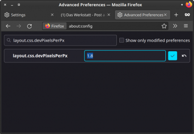

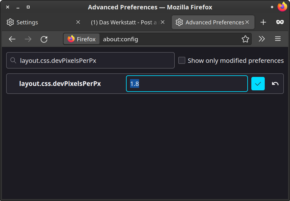

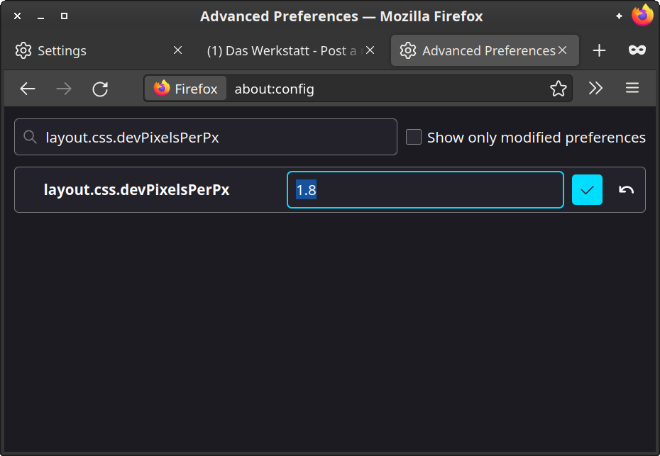

4) (optional) Firefox scaling
In "about:config", edit the following value:
layout.css.devPixelsPerPx = 1.8
I've used this before, when I had set the custom font DPI to 72, and resized everything else. Didn't work too well. Especially messed up font-size (suuuuper tiny) in all Qt applications. Anyways: Now you know a way to zoom Firefox's complete UI if you like. Not just the websites (that's "Zoom").
